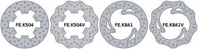

                  • Ferodo
                  • France Equipment
                    • FE.K504 (270mm)
                    • FE.K504V (270mm)
                    • FE.K841 (230mm)
                    • FE.K841V (230mm)[attachment=0][/list:u]
